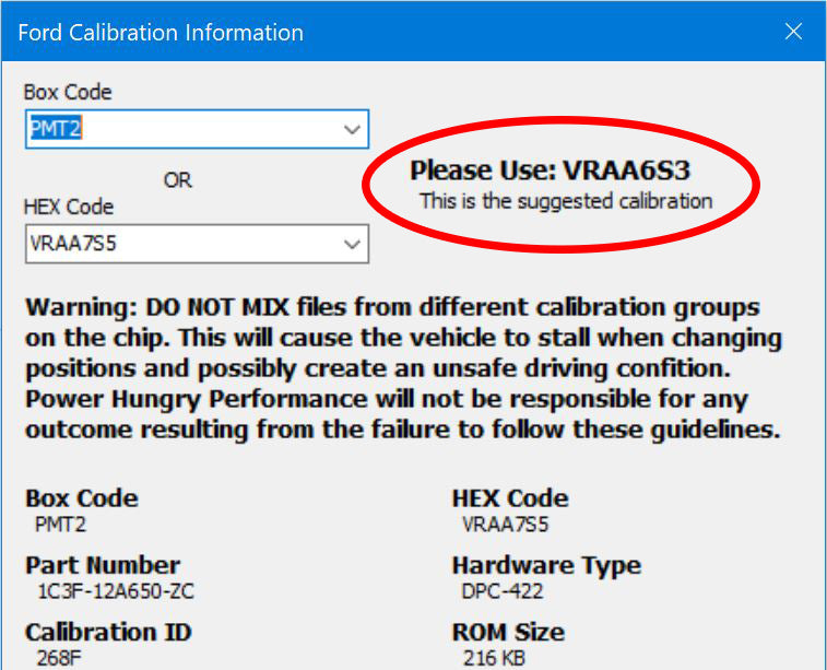

HydraFlash: I can’t find my HEX code in the list of available tunes.
We get this call quite often.
"I used the Box/HEX conversion tool and the HEX code it gave me isn't available to choose from."
If you will look directly to the right of the box code and the corresponding HEX code, you will see the suggested calibration.  This will be the HEX code you chose from when using the files off of our server.
